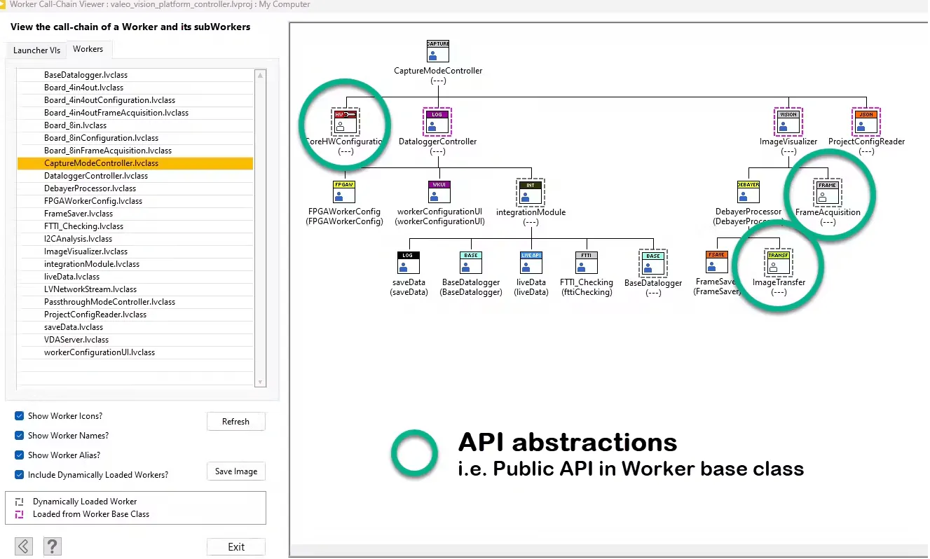

APPLICATION BUILT
We developed a modular PXI-based validation platform using PXIe-148x Chimera cards for GMSL1 and GMSL2 SerDes communication, with migration plans toward GMSL3 support in LabVIEW 2025 Q3.
The system was designed with a strong focus on abstraction and modularity, allowing the application to remain scalable and maintainable as the platform evolved.
Hardware Abstraction Layers (HAL) were used to decouple hardware-specific implementations from the core application logic, making it possible to add new boards and hardware configurations without modifying the main codebase.
Communication between modules was handled dynamically, avoiding direct dependencies and increasing overall system flexibility.

APPLICATION WORKER CALL-CHAIN DIAGRAM
