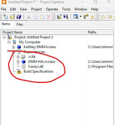

I am working on building a PPL plugin architecture for the Shipping example in the DMM HAL. While I can successfully build the PPL, the example fails at runtime.
After debugging, I found that the PPL built for the HAL layer breaks during type casting. This appears to stem from the child class being dependent on the parent class. Even when attempting to build a minimally dependent PPL (similar to the Keithley approach), the HAL classes are still pulled in due to inheritance relationships, which ideally should be avoided.

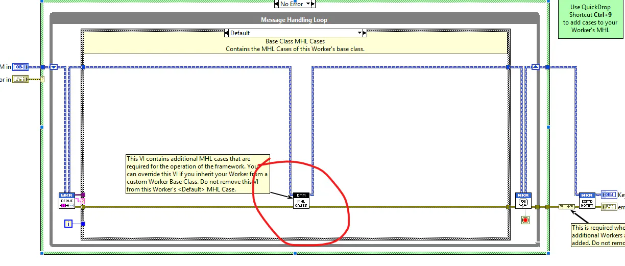

One approach I considered was disconnecting or removing typedef dependencies before building the PPL, so that the child class is no longer tightly coupled to the parent. However, it looks like the child Main VI directly calls MHL Cases.vi, which introduces another hard dependency. Because of this, even if the typedef dependency is removed, this direct VI linkage becomes another bottleneck and prevents proper decoupling.
Has anyone encountered a similar issue? Is there a recommended workflow or best practice when building PPLs for the HAL layer, especially when dealing with workers and inheritance hierarchies?
Main vi of Keithly DMM class
