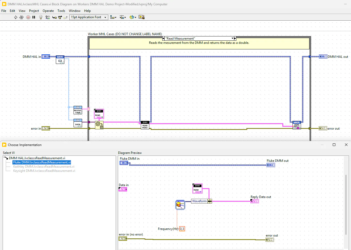

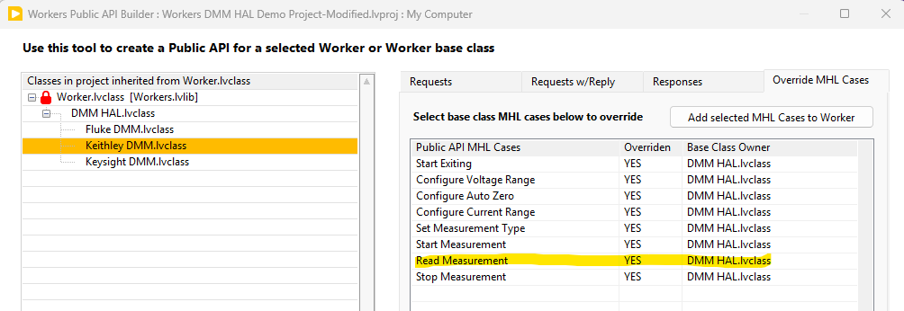

The abstraction is done by using a worker base class "DMM HAL" and the concrete devices

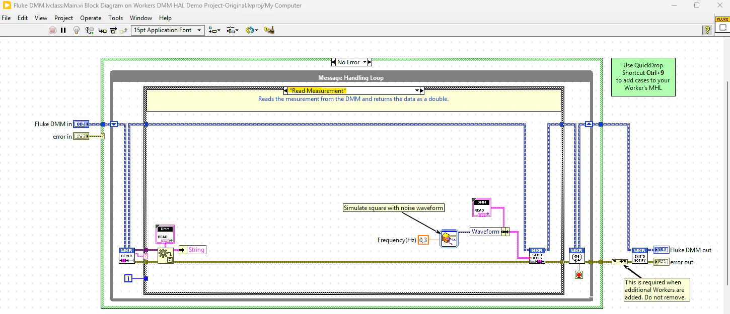

are overriding the MHL cases of the base classhttps://files-us-east-1.t-cdn.net/files/FqgMCKXXTT8mFym4dtMJj .
Original Implementation:

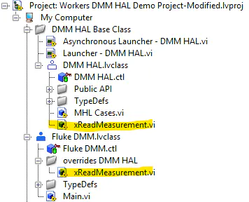

My question is , why not creating a method like "xReadMeasurement" in the base class and then just override this method without the override of the MHL case?
Is there any disadvantage? Is this against the framework somehow?
My suggestion:
In my opinion unit testing would be easier but I´m afraid of running in some problems I do not see at the moment for the reason just starting with the framework.
