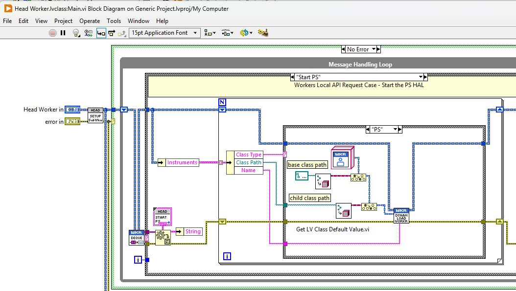

After creating a HAL using the traditional method where the base class and child classes are part of the main application project, I wanted to try launching the same HAL after moving it to another location on disk and putting it in isolation in its own Workers project. The goal would be to have no LabVIEW project dependency between the main application and the HAL that is called. An external config file is used to give a path to the base class and which child classes are launched, giving a worker alias to each one.

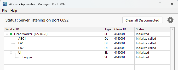

The code I created, which uses "Get LV Class Default Value.vi" and "To More Specific Class.vi" seems to be working correctly as I can launch the remote HAL and it functions normally. However, I see a difference in how the Workers Debug Server shows its status. In the traditional HAL project, all the Workers show their status as "Initialized", but in the remote HAL project, the Workers Debug Server show their status as "Initialize called", which implies the workers did not complete their initialization (even though they seem to be functioning normally).
My question, is the status shown in the debug server expected or is there still a problem to be solved here?
